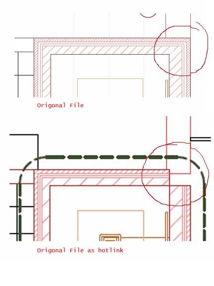

This has been driving me nuts for weeks. Can someone please tell me why a wall corner that is cleaned up in a file, gets messed up when brought in as a hotlink? See Attached images

The reference lines in your hotlink'd walls do not meet the reference line of the wall in your host file.

All the walls are in the original file, So i just don't understand why it looks ok in one file but not the other. I have been trying to match up the little dots (reference markers) but one wall goes from the first floor to the roof, so i have the reference markers set up right for the first floor, but then i cant make it work for the roof plan. So do i have to fake the wall to make this work?

No there are no hidden items. I ended up cheating the wall by splitting it and putting some parts to only show on home story, come set to cut only, and then moved the reference lines around until it joined correctly. IMO i am baffled that this is the 13th version of a architectural program and there are problems like this for walls, the most basic component of a building. I know that revit had some issues with wall joining together, but i never had this much trouble making walls work, and i never had to fake in so much stuff to make a drawing read correctly. I am very dissatisfied with this program.

My guess is that this is your issue -- one or both of your walls are joining with a wall that cannot be seen in this viewpoint (the "mystery" wall could be on a layer that is off, or on another Story).

Could it be that the layer intersection group number in your host file is not the same as the hot link file?
Seems like there is a low wall element that is in the host file that wants to "join" with the wall that comes in the hotlink...

It's how you keep walls from intersecting with other walls when you do not want them to intersect (for example, walls to be demolished from new walls) -- it's not computer programming, it's a Layer Combination setting.

It only makes you crazy until you learn to use it... then you see that it is kind of powerful. For example you can have a wall cause an intersection some times but not others, depending on how you set up your layer combos. I put demo walls on a layer that intersects w/ existing walls for demo plans, but doesn't intersect when hidden (on my reno plans).

These are the numbers to the left of the layer name (when you open the layer dialog box). Probably a number 0 or 1 by default. 1s will intersect with 1s, 2s with other 2s, etc. The really neat thing is that you can assign different numbers with each layer combo.
