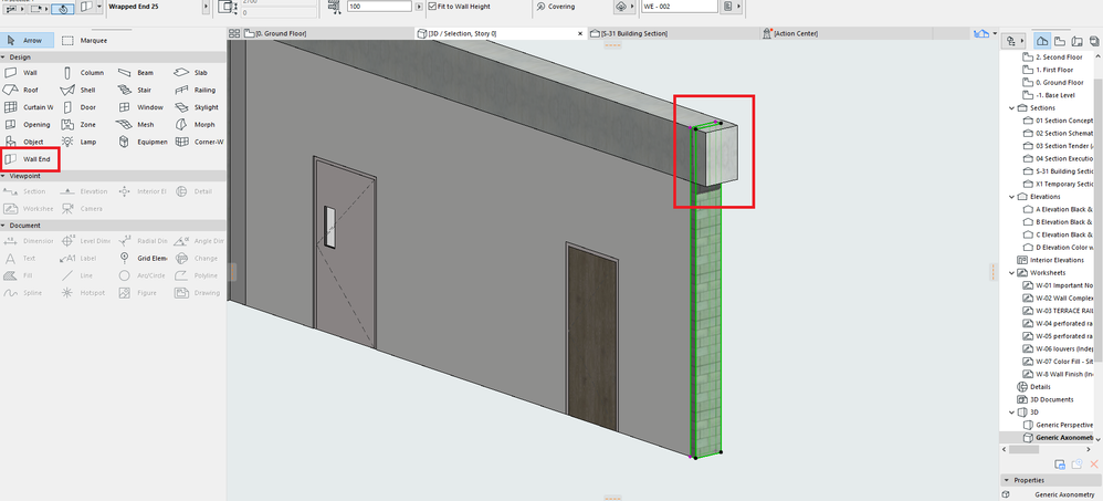

As seen in attached image, wall end placed using "Wall End" tool is not getting cut by concrete beam, based on material priority.
Please let me know if any solution for this, Or do we have to manually adjust height of wall end.

Wall End elements don't respond to priority based junctions (Building Materials), which is how the beam is cutting the wall. So if you need to stop a wall end short, like in the image you shared, you need to either use SEO or adjust the wall end height manually.

Thanks Jared,
Wish that wall end were also considered in material priority based junction.
