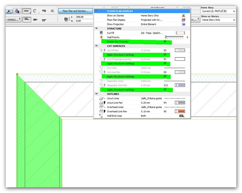

Check this settings:
Check you Model View Options Dialog.
Check to see if the Override Cut Fills checkbox is checked with the Show Skin Separator Lines checkbox unchecked.
That can cause such a display of composite Walls.

Andro: I dont think those checkboxes have anything to do with the fact that he has a composite structure (if that is the case) but the skin separator lines are not visible.
