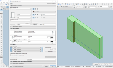

Hello,
I have a problem with a specific model from which I extracted two walls, built with the same material, on the same layer and storey, with base lines connected, but:
The side (edge) surface finish of the thicker wall doesn't get overridden, and you can see default material texture showing through, even though all wall surface finishes are overridden in the settings, for both walls.
The problem does not occur with a fresh model - only in this one.
I can't figure out what's wrong with these walls. Can you help?
Please use the attached PLN, saved in AC 25 POL.

Good catch. Yes, the walls in the file are not parallel and changing that fixes the issue.
The intersection between two walls nonparallel walls with different thicknesses naturally gets messed up when the thinner wall is to short for the thicker walls surface to extend and connect with the surface of the thinner wall. I guess this in turn messes up the edge surface override as AC probably doesn't expect there to be any edge surface between two intersecting walls. Using the legacy option for intersections fixes the issue.

Can you reproduce it with new walls in the model? I can only reproduce it by copying the thick wall.
Seems related to intersection of the thick wall, eg. if you change the intersection group number of the walls the issue will disappear.

No. The intersection group number is tied to layers so the walls has to be on different layers which might not be feasible. It was more a diagnostic comment - there seem to be something wrong with the thick wall element that is connected to intersection of walls but I can't see anything obvious.
But as said. When I create new walls in the file everything seems OK. Is this the case for you as well? Are there multiple instances of this issue in the original model or was it just this element?

I can replicate this problem in Archicad 25, there seems to be something wrong with wall intersections. My example, which is based on your situation. Two walls, different thickness, intersection. I rotated one wall 20° and get this (see the 2D and 3D view difference):
I think the two walls in your file are just a tiny amount not aligned in their direction. Here is my result with this alignment problem:
Same situation, aligned walls:
Bug? @Minh Nguyen
