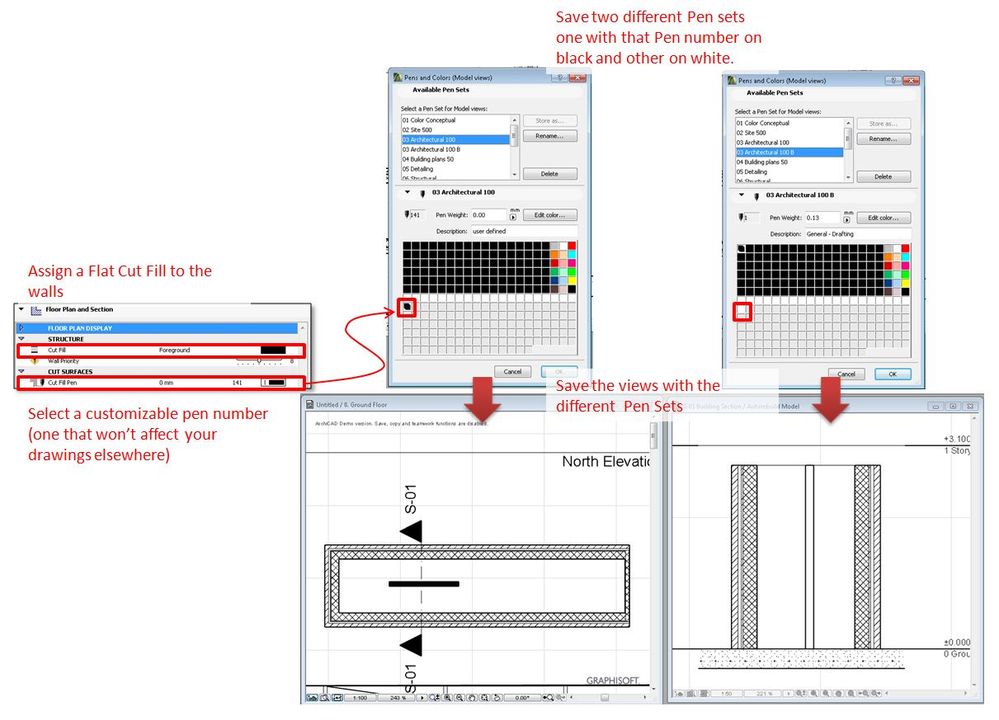

Here is a screenshots. I have two wall types, interior walls with black cut fill (Wall 1), and exterior wall with composite structure (Wall 2).
I want "Wall 1" to appear on floor plan with black fill (as now is) but on sections - with white fill.
But for "Wall 2" I do not want any difference on plans and sections.
You will need to create Two different pen sets for that purpose,
Please follow the instructions on the image from top left to bottom right.
That will work.
