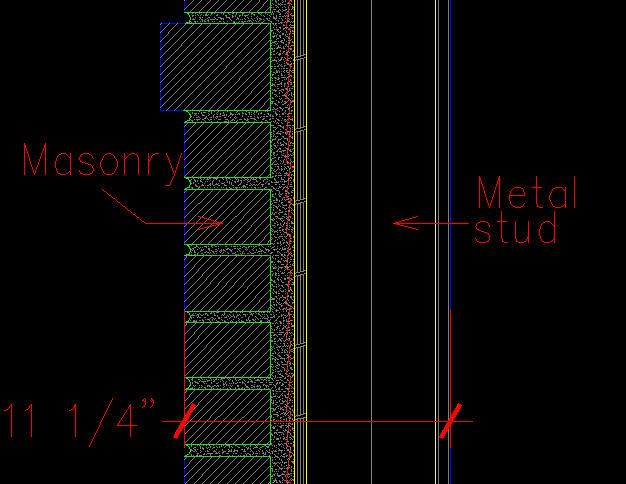

I want to create a wall with 2 composition of wall material as shown in attached image and it must look in the same way when the wall is sectioned.
Help please.

suresh_rcms wrote:Assuming you are on ArchiCAD 9:
Options/Composites
Define yours by copying the most similar one and editing it. Make sure that the composite is applicable to the walls.
Also, click on Help (make sure you are online) and search for Composites ... ArchiCAD 9 Reference Guide > Settings > Attributes > Composites
