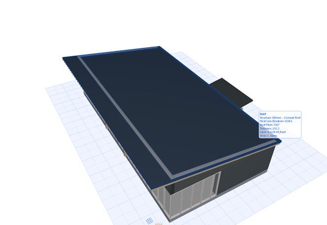

I am using Archicad 20 but when I try and trim a wall to a roof using the connect, trim elements to roof / shell tool the top of the wall is showing through the roof as per the image below. What am I doing wrong?
Please help!
2 Replies 2
The strength of the Building Materials you have used in the wall is stronger than those you have used in the roof.
Thanks Barry it worked!
