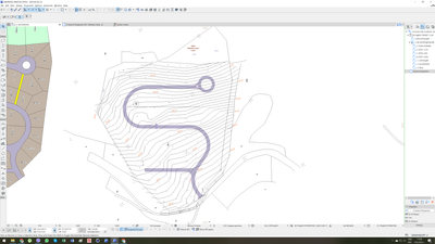

Hi all,
I've been working with meshes for a while but today I have created a mesh in the normal way but in section, eolevation and 3d it isn't showing up. The layer is visable.
What am I doing wrong?

If it does not appear in 3D, then the Mesh geometry is degenerated for some reason. Try to find the Node or Nodes in the Mesh outline or Mesh ridges which cause this degeneration.
After it is fixed, it will appear in all those 3D Viewpoints.
It is also possible that you will not be able to fix the geometry, in which case you will have to remodel it.

Hey, I have the same problem. I made a mesh for my streets in the following project, but I see only nodes, nothing else. I've deleted it several times and created it from zero several times, but nothing has changed. I restarted PC and Archicad, but nothing has changed. I can't find which nodes are degenerating, is there any other solution, that I can use?
Sharp points such as where your new road joins the existing one are often problematic. I the past I have chamfered the point a few mm.
