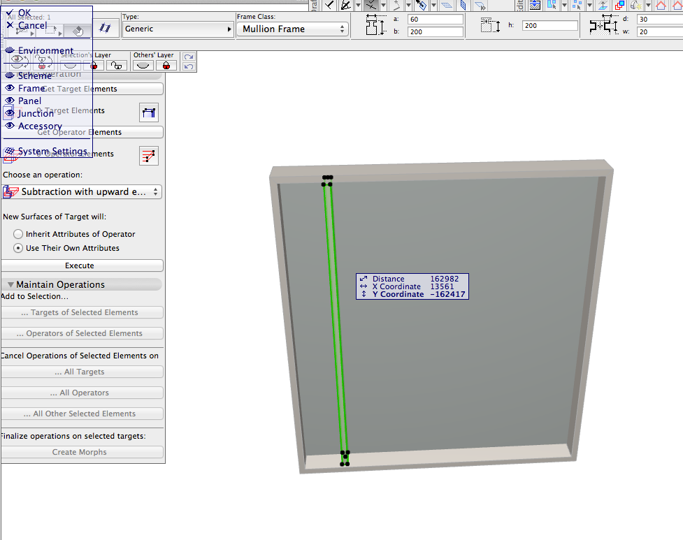

Why Curtain wall frame always cannot delete?
I always cannot delete the curtain wall's frame freely.
can any one help?

No one has this kind of problem?
Can you post a screenshot where the Scheme of the Curtain Wall is also turned on? It may have something to do with that.
I know that Boundary Frames cannot be deleted, but any other Frame should be able to.
Actually, you can also set a Frame to invisible if you don't want to see it.
