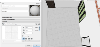

Why Is My Slab Surface Slanted Even Though Its Orientation Is Set to 0 Degrees?
mrsneuna
My slab surface appears slanted even though its surface orientation is set to 0 degrees. What could be causing this?

Maybe the slab has its own texture direction? Have you tried to Reseting the textures (menu Document > Creative Imaging > Allgin 3D Texture > Reset)
Or maybe you are working with rotated view. that way, texture allign based on Archicad origin and not the direction of your elements (then you should change the direction of the texture)
