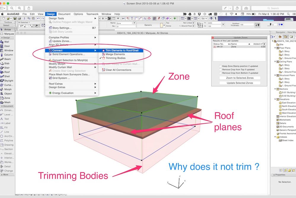

Why does zone not trim to multi-plane roof ?
Michael
Works fine for single plane .... but
see screenshot
Michael |:-)
AC 4.5 - 19 Build 3003 Full USA
Mac OSX 10.10
1 REPLY 1
Strange, it trims just fine in my ArchiCAD 18 copy.
Maybe something is going on with the geometry of the Roof. You could try to recreate the Roof and try to trim again.
