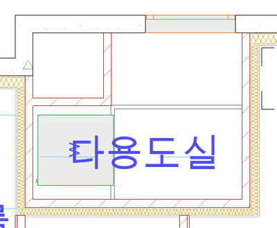

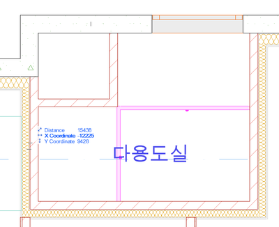

Why is hotlinked module showing in pink in plan?
LeeJaeYoung
A.
B. 
The A.pln file was imported by hotlink from the B.pln file.
However, it has turned pink and a dot is visible in the center.
I want to know what the problem is, how can I find out?
How can I find out the error?
AC27 on window 11
1 REPLY 1
Are the top/bottom wall heights in the module linked to a storey with an offset above or below that storey.
If so they may now be 'inverted' which is why they are pink.
