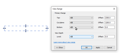

Why is there a building material that appears on the label skin list and not on the complex profile
LeeJaeYoung
The above building material does not appear. It was created as a new profile in Profile Manager
The following is created by creating it as a Duplicate profile, erasing all the fills except one and modifying one fill.
Oh! Both are walls.
Even if you copy the wall fill with the reference to the new profile to Ctrl+C, V
Building Material appears.
Why is it?
Do you need another setting?

With complex profile walls the skin list label will show only the skins that are cut by the Floor Plan Cutting Plane.
You wall must be above or below this cutting plane height.

I think I misunderstood, so I ask the question again.
Can I specify the cut plane height for each wall etc?
Like Revit's plan region...
AC27 on window 11
You can't set a cutting plane height for each wall.
It is set per plan view.
So the entire plan will have the same Floor Plan Cut Plane height.
But you can have separate views with different heights.
=> what does it mean?
     Do you mean to create each view?
AC27 on window 11
The Project Map has the storey 'view points'.
There is only one 'view point' for each storey.
If you are looking at a 'view point' from the Project Map, then you manually make all the settings as you want to see it on screen (layers, scale, floor plan cut plane height, graphic override, etc.).
You can save these as 'views' in the View Map.
You can have as many 'views' as you want for each storey (section, elevation, etc.), and each of these 'views' can have completely different settings (layers, scale, floor plan cut plane height, graphic override, etc.).
When you use a 'view' from the View Map, you do not have to change any settings, because they are all stored with the 'view'.
It is these 'views' that you place on your layouts.
