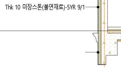

Can't skin list of complex profiled wall be used in cross section?
Below is a complex profiled wall.
2022-07-01 03:43 AM
It will only list the skins of composites that are cut by the Floor Plan Cutting Plane.

I guess I should hope for a skin list by section so I don't have to manually text/autotext.
thank you
