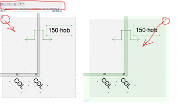

personally, i have my Magnet always turned off & space bar toggles it on/off. i have my Selection Method set to Direction Dependent. i try not to guess where the nodes are located, but instead use the Direction Dependent method to select one or multiple items. screenshot below.

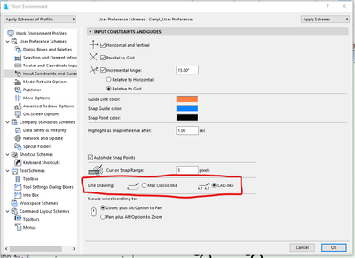

I've also got my Line Drawing set to CAD-like:

I always have selection method direction dependant as well. Saves a ton of time.
I also use cad like for line drawing
