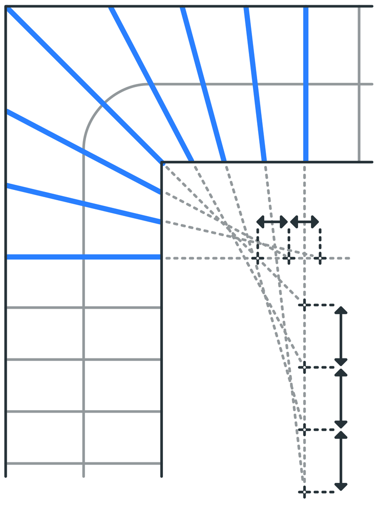

Also see: There are four different methods available to construct a Winder with Equal Goings (that is, all goings in the Stair are equal, both on the straight and the winding steps):
  • Single Point Method
  • Two Points Method
  • Principal Lines Method
  • Auxiliary Walking Line Method
All except the Single Point method have two versions depending on whether the center of the Winder is a Riser or a Tread. The detailed steps of each method can be found below.

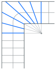

Single Point method
  • Equal goings are measured along the walking line, starting from the bottom of the stair. The going closest to the turning point is considered the Center Tread of the Winder.
  • Start and End lines of the Winder – aka the last and first straight step – are constructed, based on the Number of Winding Steps parameter.
  • Start and End lines are extended, their intersection point forms the centerpoint of the Winder.
  • The equal going points measured along the walking line are connected to the centerpoint, these lines form the risers of the winding steps.

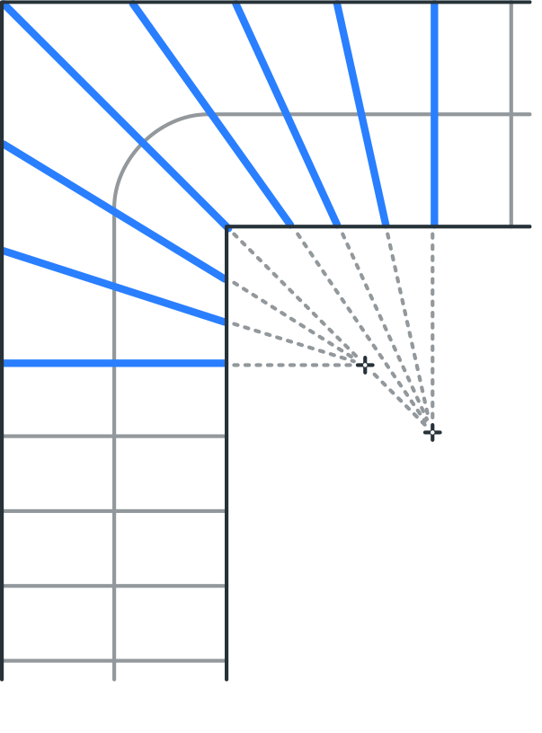

Two Points method
Riser in the Middle
  • Center of the Winder is constructed:
    • A single Riser is constructed in the bisector of the turning.
  • Equal goings are measured along the walking line, in both directions, starting from the point where the bisector intersects the walking line.
  • Start and End lines are extended, their intersection points with the bisector form the two centerpoints of the Winder.
  • The equal going points measured along the walking line are connected to corresponding one of the two centerpoints. These lines form the risers of the winding steps.

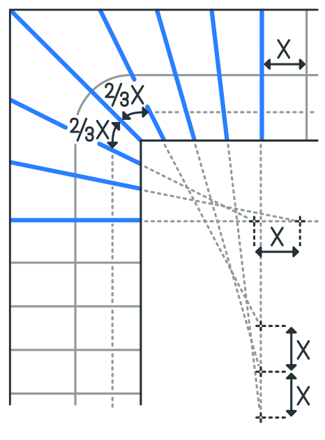

Auxiliary Walking Line method
Riser in the Middle
    • The Auxiliary Walking Line is constructed, by offsetting the Walking Line to 200mm from the inner edge.
    • 2/3 of the Going is measured along the Auxiliary Walking Line, in both directions.
    • The points on the walking line and the points on the Auxiliary Walking Line define two Center Treads.
  • Equal goings are measured along the walking line, in both directions, starting from teh Center Treads.
  • Start and End lines (the Principal Lines) are extended. Edges of the two Center Treads are also extended.
  • Going length is measured multiple times along the Start line, starting from the point where the First Center Tread Edge intersects the Start Line.
  • These points are connected to the respective equal going points measured along the walking line. These lines form the risers of the starting half of the winder.
  • Going length is measured multiple times along the End line, starting from the point where the Last Center Tread Edge intersects the End Line.
  • These points are connected to the respective equal going points measured along the walking line. These lines form the risers of the ending half of the winder.

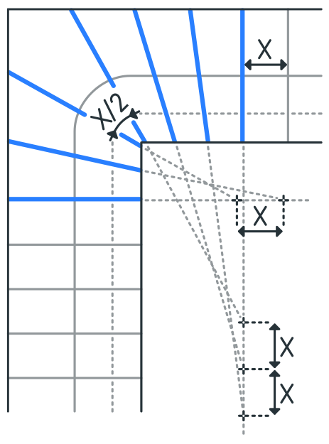

Tread in the Middle
    • A single Going is measured along the walking line, symmetrical to the bisector of the turning.
    • 1/2 of the Going is measured along the Auxiliary Walking Line, symmetrical to the bisector of the turning.
    • The points on the walking line and the points on the Auxiliary Walking Line define the Center Tread.
  • Equal goings are measured along the walking line, in both directions, starting from Center Tread.
  • Start and End lines (the Principal Lines) are extended. Edges of the Center Tread are also extended.
