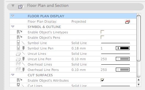

In the Window Selection Settings window, under the category Floor Plan and Section ...
What does Enable Object's Linetypes and Enable Object's Pens mean? Also, when they say "symbol", are they talking about the window label or the floor plan drawing of the window?
Because I'm working on a historic structure, I would like for the window representation in plan to communicate the character of that window.

Chris wrote:
Does anyone have advice/thoughts on which way to go? I've been using the parameters (objects linetypes and pens) but realistically, I would probably be happy with just the one pen as set under 'floor plan & section'
I would say that if one pen color and one linetype is enough, then you should uncheck the Enable Object's Pens and Enable Object's Linetypes checkboxes and specify the pen and linetype you wish to use in the Floor Plan and Section panel.
In case you need more than one pen color/linetype, then check the corresponding checkbox and specify the pen/linetype of those component parts of the Window (or other Object) in the Parameters panel.
That's about all I can say about it in this regard.
yeah laszlo, there is no need to say more, you explain it good. mc0m-if you are in hurry,you boss losing patient or want to be more productive, use one pen color for whole window.
I want to focus on your other wish:
What do you mean? It can be shown in plans scaled to 1:20 or 1:10 but I cannot imagine it with 1:50 and 1:100! Is it a CAD problem or a drawing problem? Could you do it if you were drawing by hand?

Right now I'm working at 1/4" and 1/8", and yes, it could be shown by hand.
