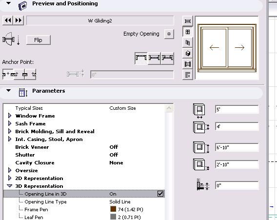

Window: Show Opening in 3D
Besides the fact that the Casement windows are shown reverse to US Standard, how do you show a simple Slider with one panel fixed and the other operable. the Slider that I am using is the "W Gliding 2". If "Show Opening in 3D" is checked, both panels show as gliding. Is there a parameter that I am not seeing?

Is it possible to simply turn off these arrows? I don't care about "operating" the windows, I just want to show a clean double hung window in elevation.
Eduardo Rolon
Yes,
If in AC13 or 14 it is a Model View Option.
In AC12 and earlier it is an option for the Door or Window.

So does this mean with Versions 13 & 14 it is an "all or nothing"? Can the appearance of the arrows no longer be specific to the window itself?
Eduardo Rolon
In AC13 it is all or nothing though you can create different MVOs to control it on a per view basis.
After all the confusion with the change in 13, (do a search in the forums since this is asked almost once a week), you have an override in AC14 for individual doors and windows.
