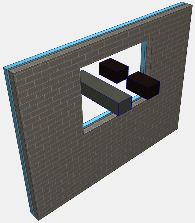

mRalin wrote:That's actually not the case, the elements are cut by the wall. You can pass a beam through a window opening with the same layer priorities as long as the beam is using a building material with a higher priority than that of the wall.
The wall with the opening must have a different layer priority then the layer of the elements that pass through the opening. The elements are cut by the opening in the wall, not by the wall building material.
Hope that helps.
