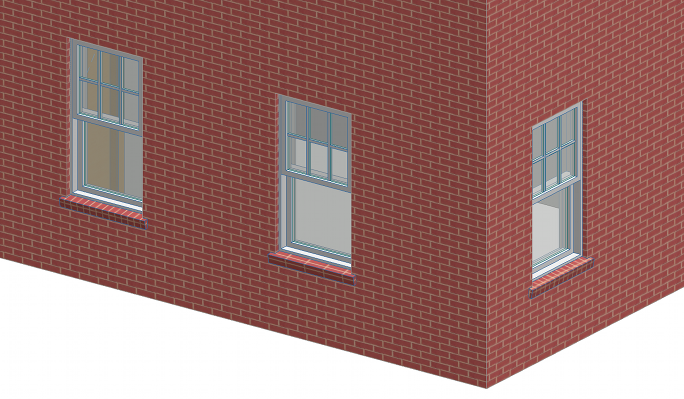

I am trying to use the brick sills that are included in the "Window" function.
The materials won't cooperate. See the image. The on on the left is 04 Stack Bond, the middle is 04 Soldier Bond (which is what I would have thought would work), & the right is my own version of Soldier which is rotated 90 degrees. simply need to lose the horizontal joints there. I've tried everything I can think of, & it's driving me crazy to not be able to do this very basic thing.
Does anyone have a solution or trick for me? A new bitmap perhaps? My next thought is to copy/modify the bitmap for the texture, but those seem to be buried in seven layers of hell. Does someone have one they can send me?
Any help is much appreciated.

Unfortunately texture mapping is not possible with objects (GS, please let it be possible in the near future!).
The only workaround is to have a new texture of bricks made of only vertical joints.

Thanks for the info, but how do I do this? The texture bitmaps seem so deeply embedded in the file structure, then inside an .icf file. I would have already done it if I could have figured out where to do it. It shouldn't be this hard. Do you have one you will share? Thanks.

You can extract .lcf library file into folder, work on the selected texture with a photo editor and load into library again.

I assumed as much, just haven't figured that out yet. Seems like a whole lot of trouble for something very basis. Thanks.
