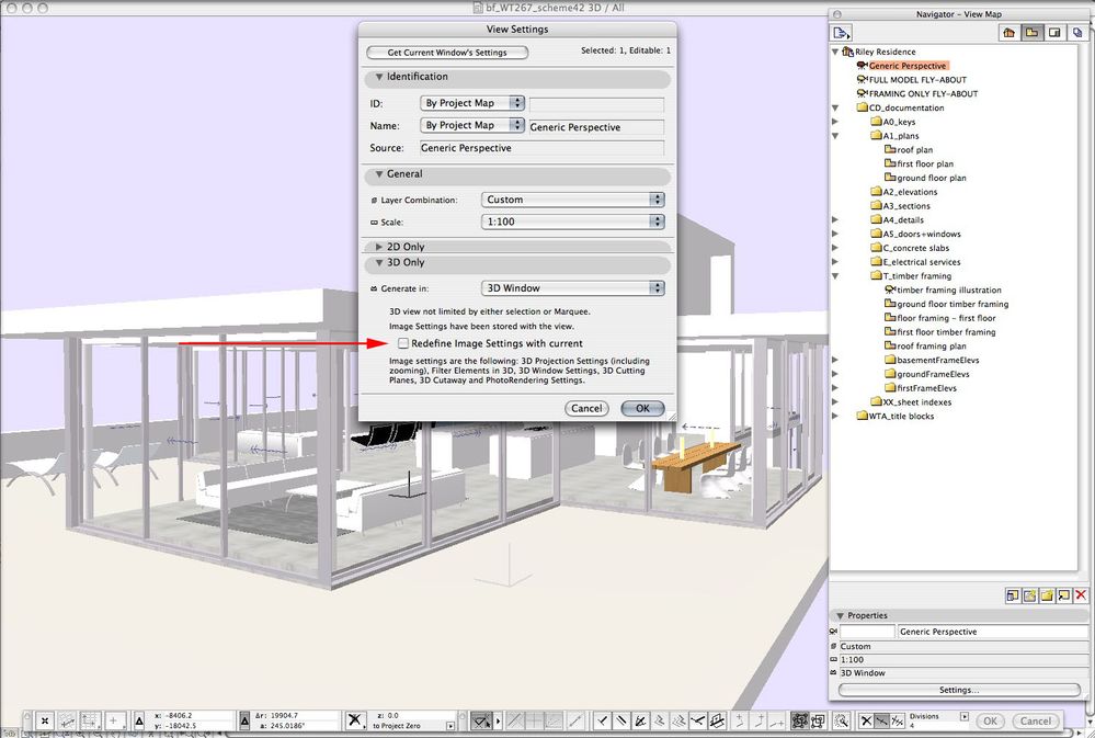

In 'View->3D View Mode->3D Window Settings' you can set the transparency to 'off', then the next time you make a view of an elevation, the windows will be opaque. However, if you left the transparency on when you created the view, there is no way to redefine the view so the windows are opaque.
I created two views of the same section -- one defined when transparency was on, and the other when it was off. Sure enough they each memorized their own transparency setting.
The question now is, How do you redefine the transparency state of a view? There is no transparency option in the Settings, and I have tried setting the transparency, popping up the settings dialog, then clicking OK, but it won't redefine the transparency. Currently, the only way I can solve this problem is to delete the original view and define a new one. However, I have a drafter who has completely annotated an exterior elevation, and has the transparency in the wrong mode. I would prefer not to lose all the associative annotation.

i'm using the 'Redefine Image Settings with Current' button in the 3D Only pane . . . works a dream.

THIS STILL DOES NOT WORK FOR SECTION/ELEVATIONS!!!!
what do we have to do graphisoft? for [censored] sake?!!!! there used to be a simple 'redefine' button in archicad 9. and there were a lot of blue-faced people telling you to re-instate that same 'redefine' button during the development and testing of AC10 . . . "oh no," you said, "there's a 'Settings' dialogue now...."
so what now? how do we redefine section/elevation views after changing 3D settings?

The only way I've found to 'work-around' is to open the organiser, delete the offending saved views, and after setting 3D window settings to no transparency I drag the S/E's from project map to view sets
the lesson for me is: ensure the 3D window settings are set to transparency OFF, and then define your S/E's
