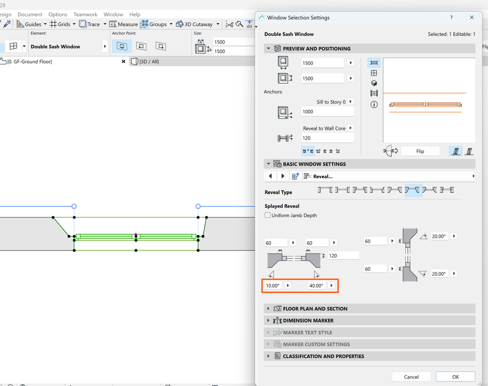

I want to create a window with a negative reveal externally (ideally with a chamfered angle) and splayed reveals internally (but each internal side with different angle). The custom reveal allows for internal and external reveals but the reveals to each side are rectangular rather than splayed. Is there a means of creating a custom reveal with differing splayed internal angles?

If you set a splayed reveal untick the option "Uniform Jamb Depth" then you can set the angle differently for each side as shown below:

That works fine when you want a reveal on one side. When you select the custom reveal (far right option on the reveal type) you can set both internal and external reveals.  However this only allows one to set a rectangular distance for a 90˚ reveal but annoyingly not an angled reveal.
