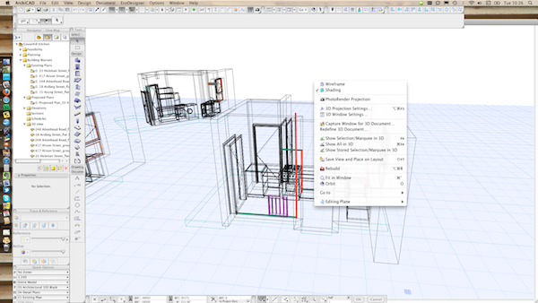

We are working on a file where the shaded view option does not work in the 3D window (see attached screen shot). THis is in both open GL and Internal render engine.
We have opened this file on a machine with full AC16 and it still does not work.
Video card / RAM etc etc are all to Graphisofts spec and the problem can be replicated on several machines. Any clues?

Check the Layers. I think they are set to WIREFRAME!
Genius! That is exactly the problem. I didn't know you could do that.
Thank You.
