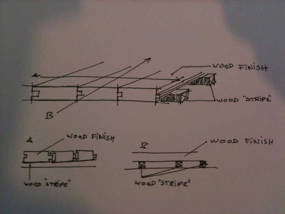

I'm having a doubt on Archicad 15 abou modeling a wood floor. I want to model an interior wood floor but I want to do it so that when I do a section I see the direction of the wood finish correctly according to the section direction. I added a small scheme where I have direction A where I see the top of the wood floor and direction B where I see it's length - and the opposite for the wood "stripes" that support the wood floor. Is there a simple way to do this or I should do it in 2D?

Do it in 2D, is easier that way

Use the object "Battens for Roof Tiles 15.gsm" in AC15 Library.

Thanks for the quick answer guys. I will try it with battens first and if I'm not satisfied with the end result I will do it in 2D!
