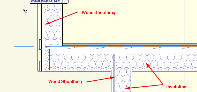

I have altered a few of the Default AC17 Intersection Properties for some of the Building Materials (BM) and have also added a few new materials like Wood Joist, Wood Rim. I am curious what others are doing?
attached is a section with (2) floor and wall intersections. The wall contains a BM called "Wood Sheathing" that I believe is a default BM (I also created a Wood OSB). The upper wall and floor intersection is good, but the lower wall is not. What is any advice in this situation?

Changing the Insulation Intersection Property (IP) to 651 Fixes this situation, but I am afraid that it may create different IP conflicts down the road.
Here is a few of the IP that I have changed (on the right) from the default AC17 residential (on the left).
