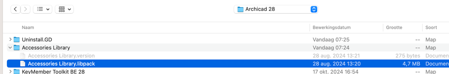

Hello Denis,
First you need to install the archicad 28 goodies:
https://graphisoft.com/downloads/goodies/
When you have them installed you will need to load the accessories library (installed by the goodies in your AC28 folder):
Previously this was loaded automatically but this is apparently different now due to the new library system.
