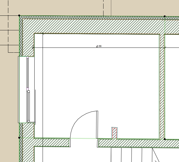

Hello to all!
New to ArchiCAD and I am facing a zone issue in one of my projects. I have a room but when I try to make a zone it says that "no closed polygon found". I tried with the fill tool to find where the problem is and as you see in the attached image, it is in the connection between the wall and the column. For sure these are adjusted and are on existing status. Where could be the problem? Thanks!
Does the Wall butt against the side of the Column?
If so, that could be the problem.
Make sure that the Reference Lines of the Walls connect properly and then there should be no error in the Zone recognizing its boundaries.
Exactly! That was the problem. I thought that when you have a grid of columns, when you connect them with walls you cave a closed polygon.
Apparently the walls have to intersect inside the column so as I can have a zone. Why isn't this done automatically as as the walls touch the column?
Hope this intersects only the reference lines and not raises the wall's area
The body of the Column is automatically cut out of the body of the Wall and that will be reflected in the area and volume of the Wall, so no worry.
