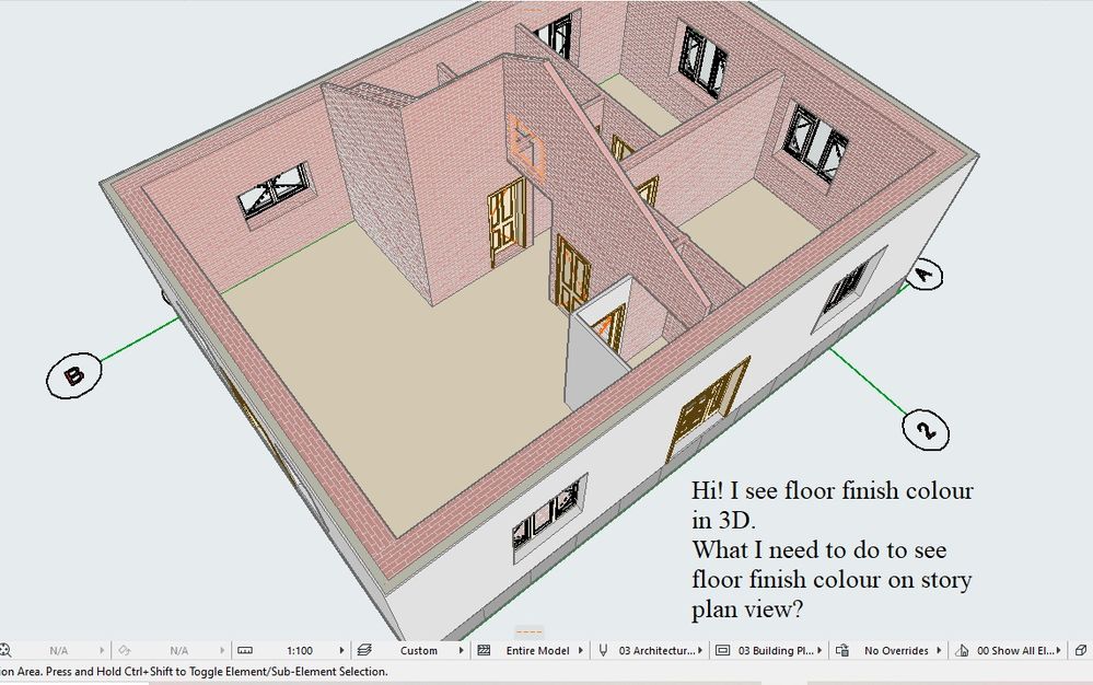

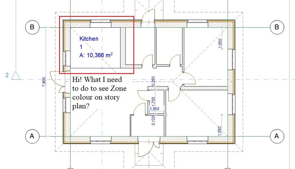

What do I need to do to see the zone colour on the story plan?

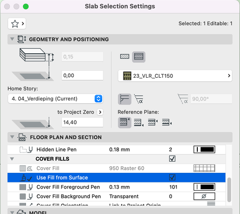

You can turn on the coverfills in the slab settings and turn on cover fills + use fill from surface.
This will display the fill connected to the surface. (cover fill foreground)
Cover fill foreground = Vectorial hatching (in AC 26)
Make sure you don't override these settings with graphic overrides.
