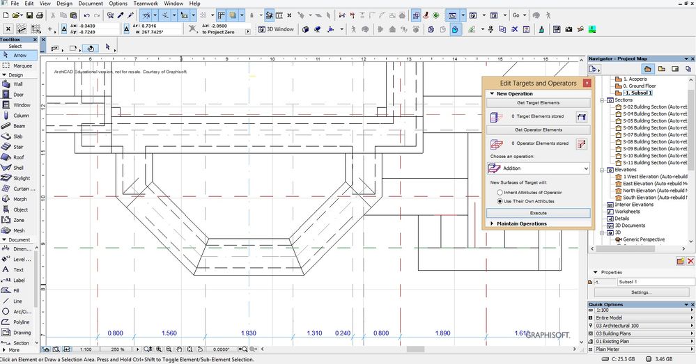

I hereby attach two pictures, a plan and a perspective. In the 3D, the beams intersect rather neatly, but in plan they do not. The dotted lines defining one beam do not intersect with the lines of the other beam. Why is this, does anybody know?

Are you sure that the end of one Beam is in the same point where the start of the connecting Beam is?
You can select any twoconnecting Beams and use the Intersect command to make sure they correctly intersect. The command can be used in 3D as well.
It worked as soon as the ending and starting points of two intersecting beams were the same. Thank you
