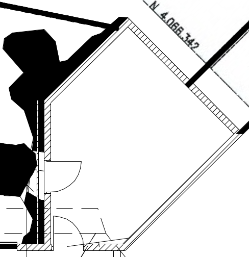

looking at the plywood roof sheathing in this example .
It looks correct in the complex profile window on the left but when i use it in the model and cut a section it is wrong
Is this a bug?

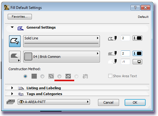

Hello,
I am having a related issue - the fill orientation for my basic wall (ie not a composite or complex profile) does not respond when I change the building material fill orientation option to "element origin" rather than "project origin".
This means that the fill for my wall remains aligned with the project origin, when I am using a basic wall.
I'm not sure whether this is a bug? To get around it I could create a composite wall that looks like my basic wall, but this seems like a bit of a long way around!
- Mark as New
- Bookmark
- Subscribe
- Mute
- Subscribe to RSS Feed
- Permalink
ā2014-01-22 04:56 AM
ā2014-01-22
04:56 AM
I think this is more by design (or a limitation of Archicad) than a bug.
It has always been this way.
Create a composite for even the simplest of single skin walls.
There is a warning in 17 as shown in attached image.
