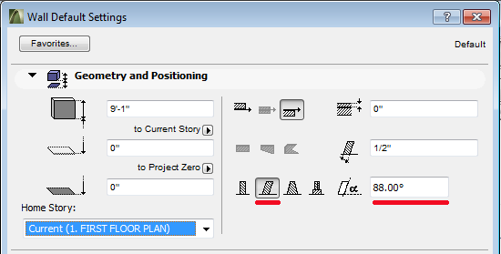

canted wall
Embarrassing, but now can't remember how I got the baluster
"wall" to tilt back.
I converted them to morphs, so can't go back and see what I did to
tapered walls to get them to tilt and miter with the others that make up
the baluster.

See image, AC calls it slanted wall.

Just place 4 slanted walls (one for each side of the post) and so long as their reference lines touch then they will mitre and for the taper you want.
So the walls you place will be as long as the base of your post and the top slanted in towards the centre.
As Barry says: The canted wall in your image must be wider at the base.
Once the base of each wall touches, and they are all canted,
then the cants will self miter all the way up.
