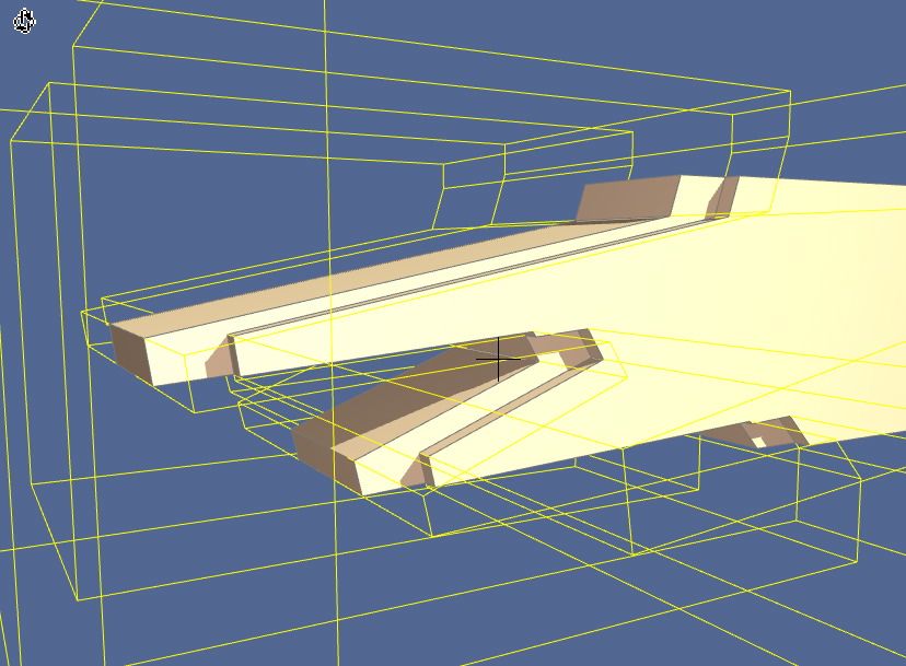

Build a group of complex profile walls to either auto-cut or SEO the beam end. Think of the group as a special trimming object.
In this image, I've overlapped several complex profile walls to step the cut.

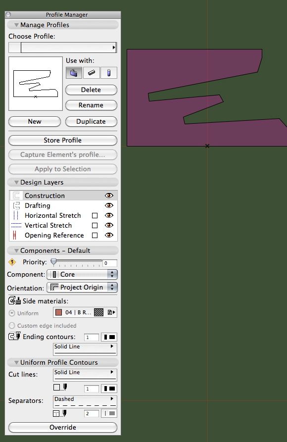

The principle is to EXTRUDE a shape with the wall tool.
1: use a fill shape to make a complex profile shape, assign it to wall use [distinct from wall, beam and column uses -to keep the complex profile choices manageable for each tool].
2: Use it in a wall ACROSS the axis of the beam. If you have the wall/beam priorities correct, the wall automatically cuts the beam. But you can't see this until you make the wall into a wireframe layer. If you don't get the priorities right, use the SEO function to trim the beam.
3: You'll edit the fill to change the shape of the trim and apply it to the conditions you'd like to edit.
4: Group these elements to make them travel with the beam.
See Eric's article: the three bunny wunnies have a picnic
Now, if having the construction drawing benefits and behaviours of a real 'beam' isn't important, you can make the entire beam element from a wall complex profile element without any trimming. You'd use a fill derived from the building section, copy the fill to the complex profile editing window and then draw ACROSS the axis to make the wallbeamthingy.
This approach solves numerous modelling challenges in Archicad where the SECTION PROFILE defines the shape of the sideways extrusion for ballustrades, medallions, logo signage - whatever!!
Oy Vey!!! Experiment, already!!!
