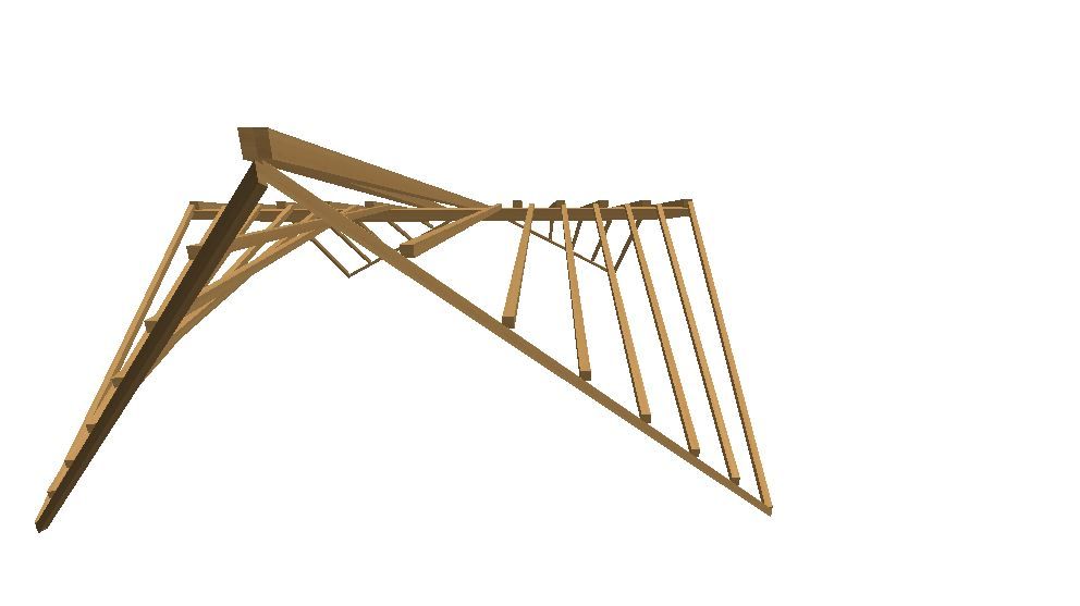

compex roof design
I have a complex roof design like that in the picture. I want to lay a roof cover on top of this frame but I can't do it. I tried everything I could. even to cover with a mesh and modify elevations to simulate a roof.
Anybody has any idea how to make this roof?
Please help

Thomas Holm
Check here for "hp-flaeche.gsm":
http://www.archiforum.info/ubb/ultimatebb.php?ubb=get_topic;f=3;t=011673
It appears that your roof is intended to form a hyperbolic paraboloid surface.
Is this correct ?
In what way did the mesh tool not work to form this type of surface ?

You guested ok that this is a hyperbolic paraboloid surface. I haven't succeed to reproduce this with a mesh because the mesh tries to interpolate between points with plat surfaces.

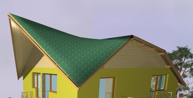

Thank you all for your help. Both objects suggested by you worked. Tentmaker and Mesh3d V2. I choose mesh3d V2 because I can set thickness also.
I attached a a render with the actual status of the roof now.
Looks great! Glad it worked for you.
