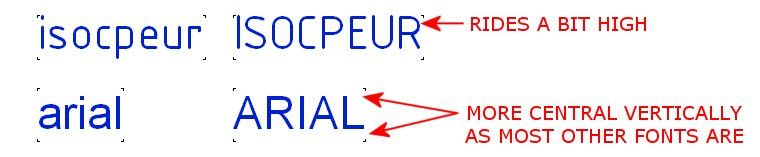

Is there any reason for NOT using these "AutoCAD" fonts? I also use ISOCPEUR, with no crash trouble. The only thing is it sits a little high in its bounding box. See image. (Leading value is 100%)
Is there a similar ISO font which is Archicad friendly?
Cheers

No reason why not to use them ... if they are TTFs (Windows) except for their not so good legibility - the original SHX were made for pen plotters and I reembert having pen weight issues even with associated TTFs, so avoid them as and when I can.
