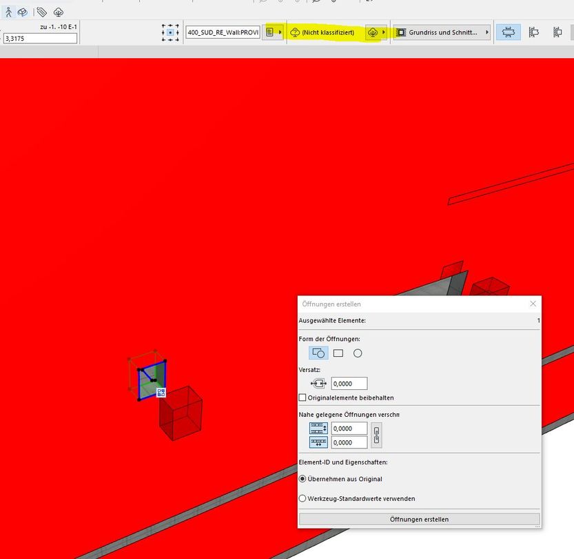

Hello,
I have a problem with the "create opening fromm selection" tool.
I imported  PROVISIONFORVOIDS from an IFC correctly. I did a mapping to import properties of the PFVs and then transfer them to the automatic generated breakthroughs but it is not working because Archicad (26) does not classify the generated breakthrough as opening.
Does anyone know what I am missing or if I am doing something wrong?
Thank you very much for your help.

Nevermind, I found what I was doing wrong. I did not have the opening tool preconfigured with the opening classification
