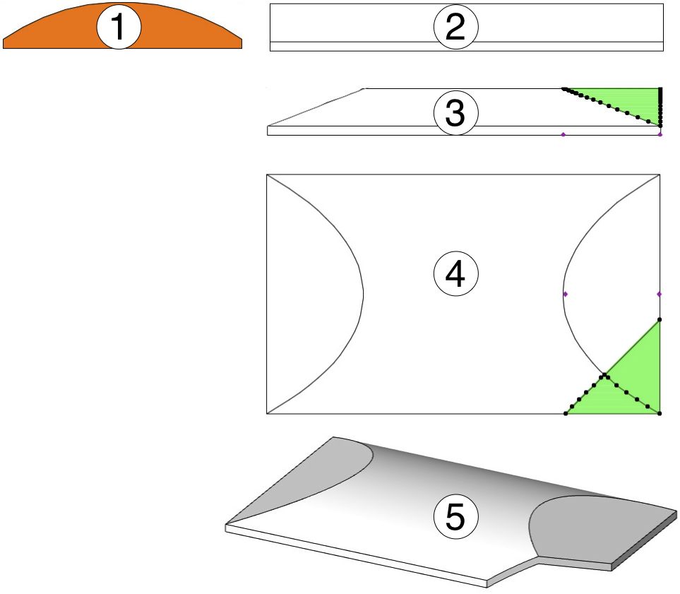

dapDesign wrote:I'm not clear on all the details you are trying to draw, but I think you can do this with OBJECTiVE. Referring to the attached example:
I am making a vaulted roof using complex profiled wall and two roofs. The wall is the vault and is trimmed to the roofs. The finished product is rectangular but the building is a polygon. One roof corner is projecting through a wall where it shouldn't. [] I get the impression I can do all this with OBJECTIVE.
2011-02-01 07:27 PM
2011-02-01 11:22 PM
dapDesign wrote:Can you provide a sketch of the proposed roof?
That is great. However the corner that you cut off angles upward. I need that to edge to be at the same elevation as the rest of the spring line for the roof.
