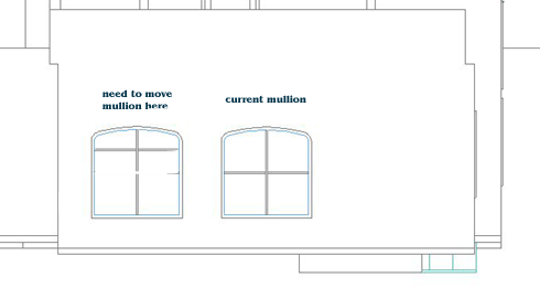

Using Eyebrow window under windows classic 81. The mullions are not editable for location. Can I open the gdl object and save-as to a custom window? How can I then add parameters or change the mullion height. Please see image attached. Thanks

But shouldn't it be easy to convert the eyebrow window to a new 8.1 eyebrow, with custom mullions which are hotspot editable?
Or, couldn't I just go into the .gsm elevation view and move the horizontal mullion?
It is difficult changing the code for complex windows - you have learn a lot of GDL to be able to do it.
If don't have many windows in your model try putting a small wall with the same size and material as the mullion at the desired place. It's not very convenient but it works

For a single transom in the WEyebrowsFix window LIbPart insert this after the second line of the 3d script:
! transom definition
material gs_frame_mat ! transom material def-> same as frame material
addx -a/2
addy htr
brick a,gs_frame_thk,gs_frame_thk
del 2
! end of transom definition
and add a new variable for the vertical position of the transom : htr
transom material will be the same as the frame material.
So you will get a result like this - it's ok when you render it

The question, how can I change the Transom Thickness to be equal to the mullion thickness?
The problem created is pasted below: the 3d window now shows the window "off-center" in the wall, while the hotspots still show it being centered in the wall on the plan.
Thanks in advance
Try this, I hope I did it better this time
addx -a/2
addy htr
addz ztr
brick a,gw,gth
del 3
Thickness of the transom is the same as that of the grill - so you can control it this way. Aligning the transom to the grill turned out to be very complicated (and I'm a bit lazy ) so you will have to insert a new variable, called "ztr", and adjust its position manually.
Thanks Kilment!
Worked like a charm!
