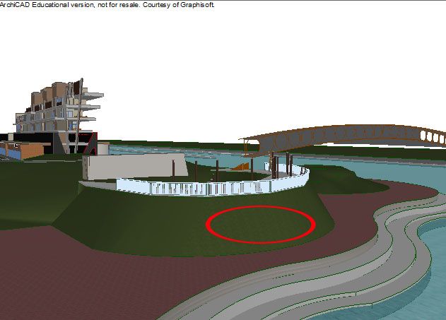

I am wanting to integrate facilities into this hill. is there a way to cut to thru the mesh?

Just like any other polygon ... select the mesh with the mesh tool active, draw the hole. Done.

Or use what you are adding as the Operator of an SEO operation with the mesh as Target.

i would go with a SEO also.. due to it(the mesh) being able to repair itself if u change your mind on whats going in the hole
what is SEO? i did a search in help but it didnt come up.
Dwight
"Solid Element Operation"
http://www.archicadwiki.com/Solid%20Element%20Operations
in geek: boolean
cut one with another, intersect and join....
