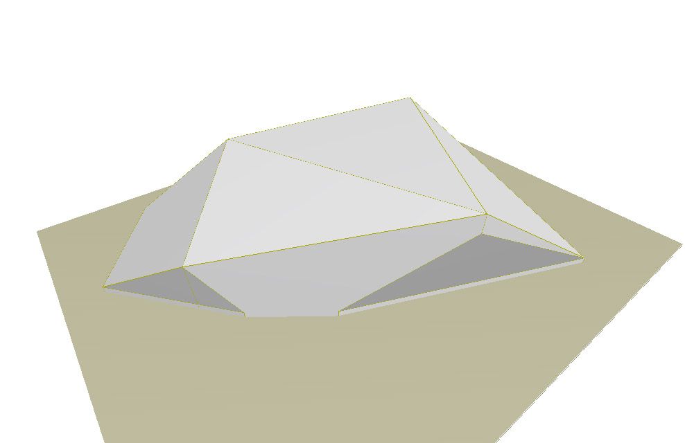

I`ve made some form using mesh tool and solid elements operations (please see the attached picture - I think it is not possible to make something like this, such triangulated forms only with wall tool in archicad??? or I am wrong!?!)
anyway, now I have to draw the floor plans inside, but I really don`t know how to cut that shape horisontally so I could get the outlines of each floor? is there such tool in archicad? any suggestions?

so the question is still: is it possible in archicad to cut the mesh form with some horisontal planes so that one could see the cut lines and use them as a borders of each floor of the building?
(I could do that in 3DS max but it wouldn`t be a really smooth workflow to bring those lines back to archicad...)
Just use the 3D cutting planes, change your view to internal engine/hidden line, and copy/paste the linework to the floor plan. Progressively move your cutting plane to the height of the next storey and repeat.

It may be possible to build this shape using roofs.
Roofs react to the floor plan cut plane so each floor
could be on it's own story and the outside walls
as roofs would display correctly. Unfortunately,
the mesh to roof add-on can't be used to
automatically construct the roofs because
the add-on makes each different pitch of roof
have a different thickness.

but there is one more problem: if I cut the form in desired height and set the
view to internal engine/hidden line, as you said, I am than not able to copy
those lines to the floor plan... I can still select only the rest of the forms that
were cutted, but not the lines only...
any idea?
sergiofunk wrote:
there is one more problem: if I cut the form in desired height and set the view to internal engine/hidden line, as you said, I am than not able to copy those lines to the floor plan...
Select the marquee tool, set the method to 'flat' (i.e. a simple flat rectangle), draw a box around the bounds of the lines you want, and "Copy". You will get some options for the linework and fills to be copied.

it works! thanks a lot!
