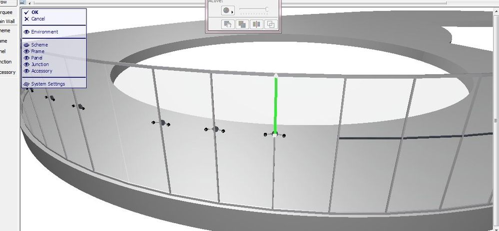

Hi i have small question that i face trouble with it why i can not delete vertical mullions while horizontal mullions deleted normally as you can see in the image

You can delete the mullion if you select all of the mullions in-line with it. You cannot delete the individual mullion you have shown since this will break the boundary between the two adjacent panels and a panel cannot heal unless it has a regular geometric shape. The mullion below cuts into the regular geometric shape and cannot stand alone, so the mullion above it cannot be deleted, unless all mullions in that axis are deleted simultaneously.

although i chose the all mullion in the vertical direction id did not deleted why ??

It did not delete in the image above because you are creating a similar situation by deleting these vertical mullions together. The horizontal mullion that intersects the vertical on the right would have to be deleted first.

Set the type of the mullion to Invisible if you cannot delete it.
i did invisible but the problem when i put doors inside this panels it become small from far space i am trying delete hopefully this panels join each other at the medium space because the entrance its door should become bigger and doors read only the panel width that i want to extend about structure i will join later junction without mullion at this medium space

I think the reason the Door is not extended wider is because the curve is made from segments and that is the size of a segment.
It cannot be greater than that.
So it does not work like it would if you removed that frame in a straight Curtain Wall.
In the vertical direction: you can place a horizontal frame in that panel and then put the Door into the panel below this newly created frame.
