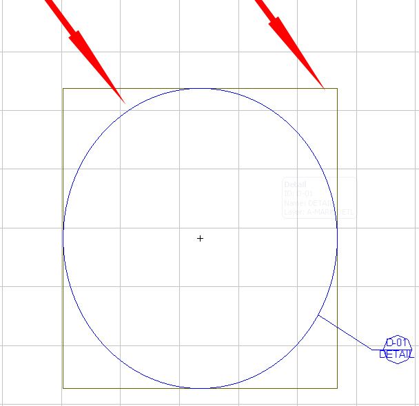

hi
that dose not work that remove the the blue line I wont to remove the black one and I can reshape the black line but I cant change the color of its?
thank you
thank you

Tne black line presetn the detail place limit. the black line is not presenting in layout it just information line, i thing is not possible to remove.

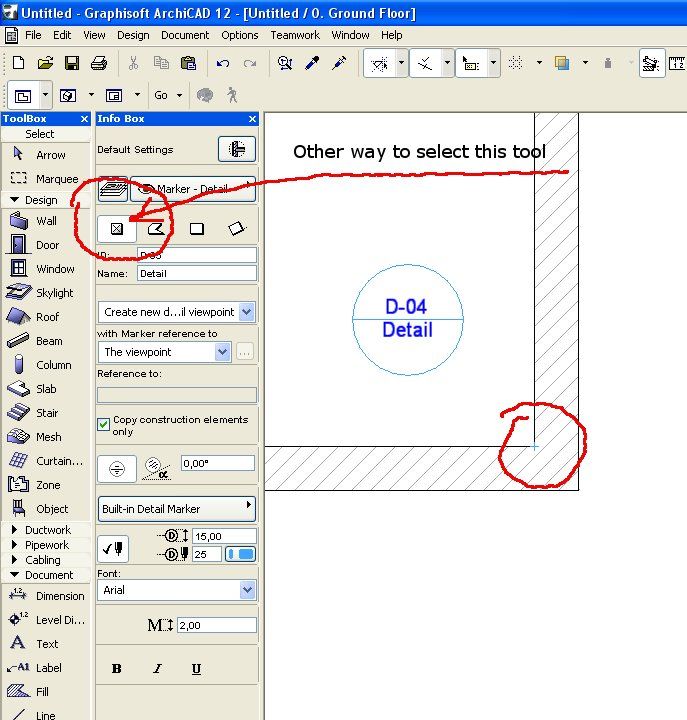

other way to make the detail. in this way you will not create the detail view, but will not have any line.
see picture
see picture

nourqueen85 wrote:The black line is showing the extents of the detail. It does not print or show in the layouts. It is only showing which part of your plan, section or elevation is included in the detail.
hi
thank you
Do not worry about its colour ... why is its colour important anyway?

The visibility of the line is controlled via On-Screen Display Options > Marker Range. Its color (and line type) is set via Preferences > Miscellaneous > Line Type and Pen of Marker Elements' on-screen-only parts.
