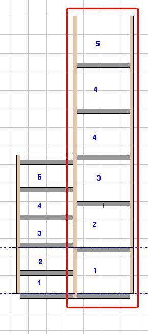

I have building with two part every part have diffrent hight story wath the best way to modiling that building ??? two part in the same file or every part in file and merge them and work the connection or any diffrent way ???

It dependence did this two building parts have connection, corridors, stairs.
If have better work on one model if not can work separately
It depends on how you name your stories/level. Once you can name them, then you know how to construct them in ArchiCAD.
Two parts of your building can be (and better be so) in one file.
Good luck
