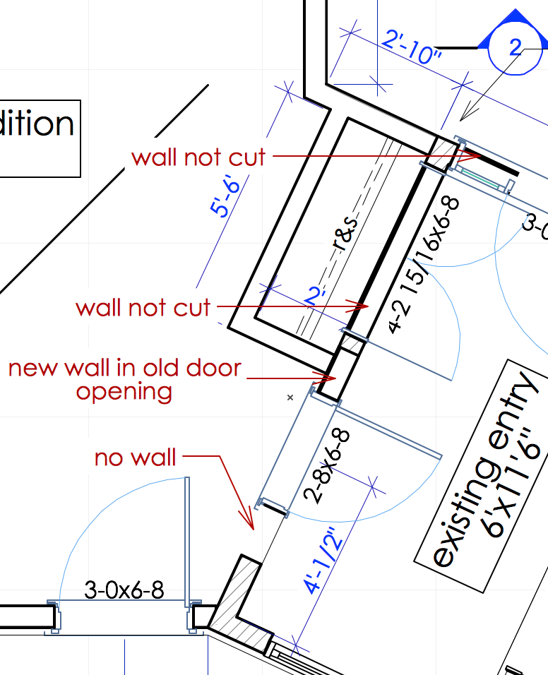

I'm having odd results with doors and walls and the renovation filters. I have placed three new doors in existing walls and set an existing door as demolished. two of the doors are not cutting holes in the walls properly (30x68 & 40x68). you can see the walls in the door openings. but the 28x68 cut the opening properly and is located right where a door set to demolished was. also for some reason, to the bottom of the drawing next to the 28x68 door, there is no wall where the demolished door was, but there is on the other side of the door. the hatched walls are existing the white are new. the three doors reno filters are set to new, walls are set to existing, door removed is set to demolish. if i set the 28x68 door to existing, the missing wall segment appears. and if i set the other doors to existing they cut holes properly.

Are any doors overlapping 2 adjoining walls?
heathldesign
Nope. only one can, the closet door, and i placed a new instance solely in the wall, same problem.

Please change the renovation filter settings for the planned status filter!
Elements to be demolished is on "Show" instead of "Hide"
See the screenshot below:
