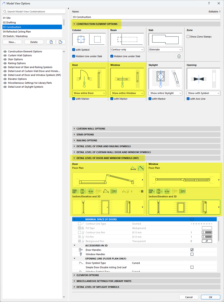

Archicad 28, Mac platform. Doors and windows not showing up in the cut sheet plans. They are plans we use to cut our wall timbers to. I know it's a setting in the Work Environment I believe, but I don't know how any more
1 Solution
It is probably Model View Options (MVO) that you are looking for.
Go to post
2 Replies 2
mukster
Thanks, that worked
