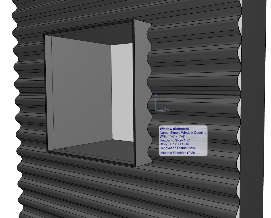

We have created a custom profile wall that consists of 7/8" corrugated metal cladding. This wall is a skin to a regular AC wall.
We want to create an empty opening in this wall that corresponds with the steel bucket window in the regular wall. Everything looks good in 3D, but in plan, the empty opening is not "masking" the full thickness of the custom profile wall.
As you can see from the screenshots, the window DOES mask a small portion of the thickness.
Any suggestions??

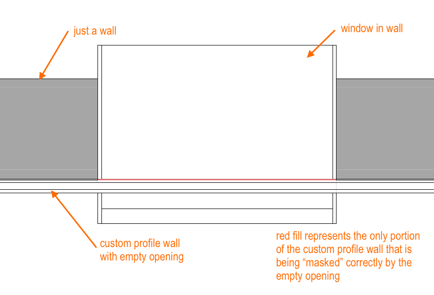

here is the plan view

Presumably your opening reference lines are set to cover the whole depth of the corrugate?
Also, play around with the symbolic vs projected vs outline display of both the wall and the window - there may be a combination that does what you want

Thanks, Bruce -
Yes - the opening reference covers the entire profile. This was our first guess.
We also played around with the symbolic/projected settings, and we just cannot get it to render properly in 2D.
The window is above the cut plane, so we do not expect projected to work. The fact that the symbolic setting only masks a portion of the custom profile wall leads me to think something is glitchy and not working properly.

Try changing the empty opening to an empty window opening (yes, there is a difference). The Empty Window Openings (in this case Rectangular Window Opening) gives more options with casing, reveals etc.
Also, given the window is above your cut plane, try changing the cut plane height to see if this has an impact.
It's not glitchy...it's just the idiosyncratic behaviour of complex profiles vs 2D display vs cut plane heights.

Hi.
I have to ask... Have you tried "Send backward" for the complex profile wall? I'm assuming those are separate walls and the steel bucket window sill has a cover fill...
Best regards.
jkershaw
good grief... "send to back" took care of the issue. Rookie mistake. I must be getting old...

That's the problem with the symbolic floor plan type of view in AC, because you might have walls set to "projected with overhead" but their interaction with other elements will still be a symbolic representation. IMHO I think this should change ASAP.
