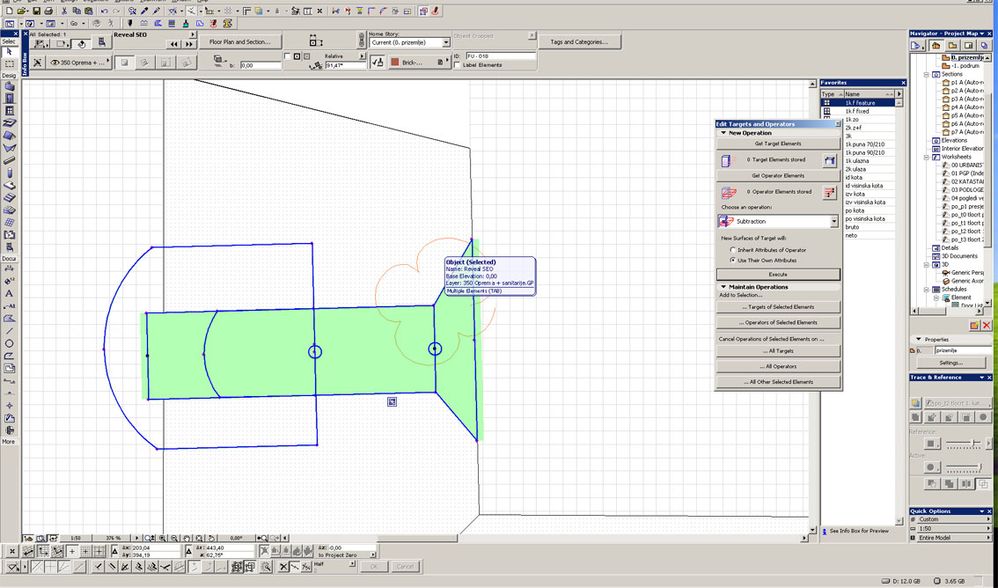

I have tryed Dentan's reveal SEO but it is way too limiting. I can't set depth of it.

hm, but my profile is changing along the axis (through the depth of the wall).
Is it constantly changing or there are two or more different profiles in it?
Sorry I can't figure it out from the image you attached previously.
here is new illustration. first are the setting of the opening that I need. and which caused the problem shown on previous picture.
below is that opening modeled with shell tool, which is useless since I can't substract it from wall.
