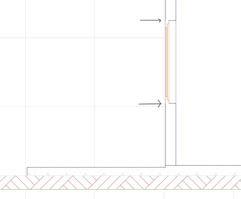

Hi, I got a problem, sometimes the wall lines wich intersects windows and doors are missing, and even the window/door is not there.
I can't see the reason. In this case it's a section, but that occurs in the floor plan too. I tried all the settings and changing linetypes etc but nothing worked. Anyone knows how to activate them?

It may be the scale sensitivity. Check the parameters in the window settings dialog.
Thanks for the reply but the problem was the cut fill type. Both window cut and wall section fills were selected as "background" - white, as I didn't want any fills, so I believe Archicad joined them, the same way it does with slabs and other elements with the same cut fill.
I don't know how to disable that, "autojoin" feature but I solved the problem by switching the window cut fill as "air space", and the line came back...
