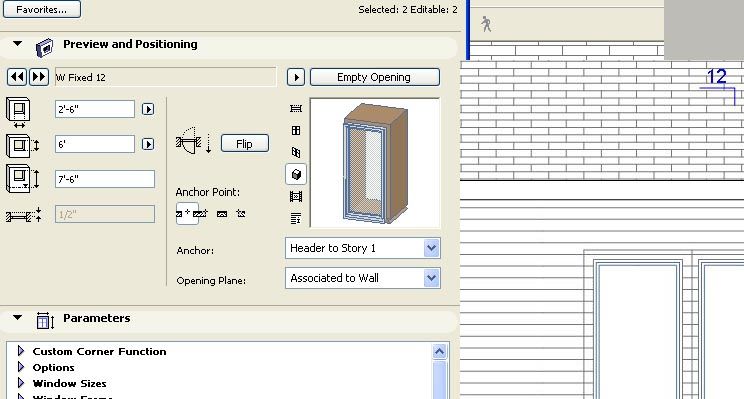

anyone know what i am doing wrong or is this another 12 feature. cannot get the siding lines to stop at the edge of the trim they go to the window frame
3 REPLIES 3
u might have the trim material set to glass or transparent of some sort.
have it set as stucco, and just to show that it should be outside the siding it is 3' thick as you see in the 3d window

Works here with the default settings (except for some pens for clarity in the image). Your elevation shows 4 lines, while I just get three (trim and frame, no sash). What does the window in the wall look like in 3D, same problem with the trim?
