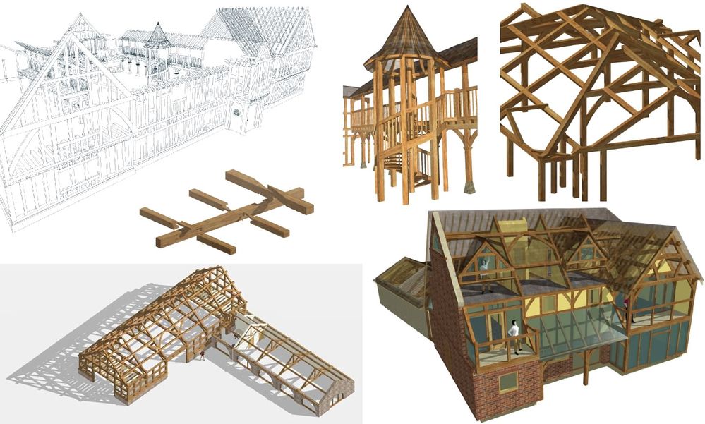

The image was intended to illustrate the level of complexity it is capable of handling - anything simpler is, well.. simpler to model.
FrameWright is designed for heavy structural timber framing, and would have more appeal for the craftsman, or master carpenter. It doesn't take walls and roofs and instantly transform it into a 'typical' framed construction. FrameWright is usually applied to bespoke or one-off designs

I've attached a smattering of images that I had close to hand. This software is capable of modelling any kind of framing, but the design methodology and tools will suit some better than others. Time varies with complexity, but from start to completed quote/scheduling is typically between 1/2 to 2 days. We offer a demo, so you could try it for yourself. I can put you in touch with other users too.

Ralph, awesome pictures.
I wish Graphisoft had a page introducing all add-ons and complex objects available, introducing them pretty much like you have done in this thread. There is so much beautiful stuff out there.

Great stuff Ralph.
It's what we generally cal type 4 HT (Heavy Timber) construction which
looks like your Frameworks would be great at.
