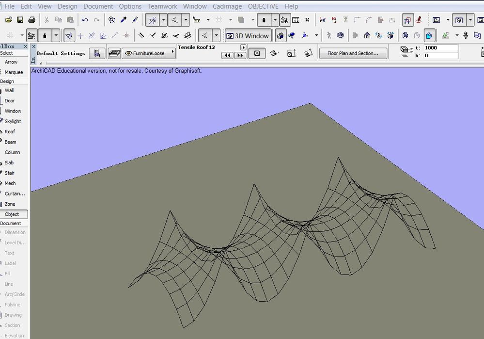

today i create a tensile roof with the basic shape lib. and at the beginning, it was all right, then i dont know what i did the tensile roof become the wireframe in 3D window and even i render or change the 3d-view to any mode, it is all like this, just has black line wireframe, even rebot the laptop, it is still no working.

Attachment is showing what is hapening...
BTW.. all other lib. parts works all right...
only this one, and it is very importnt that i will use it for next coming project.
only thing i remember is i just change the structure dimension of it then it become wireframe mode forever!

Check it's layer status:
1. Open Layers Settings dialog box
2. Check the third column for your object's layer (the first is lock/unlock, the second is visible/hidden, and the third is solid/wireframe model mode)
